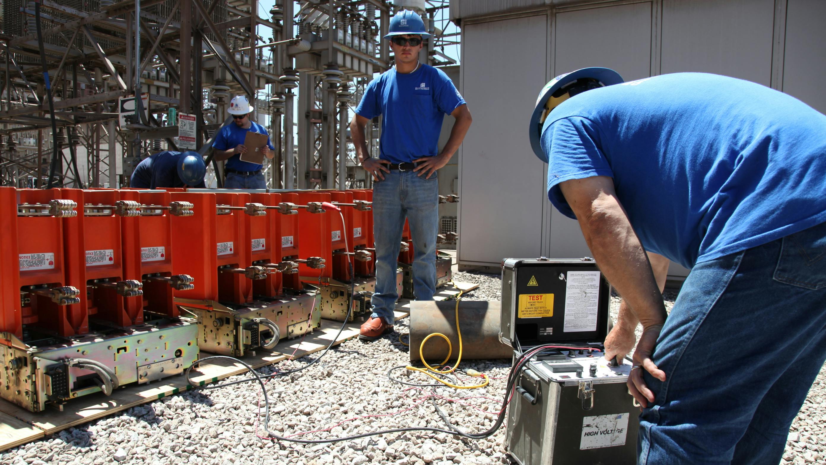

Part 1: The state of the electrical equipment
It seems obvious, but don’t overlook the state of electrical equipment. It’s the overall condition of the equipment (Photo 1) as you see it and begin to interact with it. Is it new? Service aged? Clean? Dirty? Good condition? Poor condition? All those factors need to be considered.
