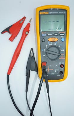

#3 Select and Inspect Test Equipment
Insulation resistance test equipment, including test leads, must be inspected before each use. Without charged batteries, the proper output test voltage may not be achieved. The physical condition of the tester and leads must ensure no danger of electric shock to test operators. Calibration is generally required every 12 months, and labels should verify test equipment is in-date.Selecting test equipment that produces the proper test voltage is critical. Too low a test voltage and not enough current will be forced through damaged insulation to indicate a problem. Applying too high a voltage can result in damaging insulation. Equipment manufacturers and various standards provide recommended test voltages. These values can be based on equipment type and the condition of the equipment (see Sidebar, “Critical Considerations for Effective Insulation Resistance Testing” at end of article).

Use the proper test equipment. A multimeter does not supply sufficient voltage to conduct the test!
