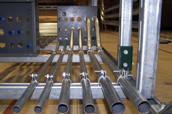

Photo 1. Conduit fabrication on a lab trainer setup provides the student with a hands-on experience.
In the case of conduit fabrication skills training, learning has typically occurred in the bending lab area of the training center (Photo). But what emanates with this initial learning approach of conduit fabrication is conduit waste, the instructor’s challenge to manage many learners at one time, and, oftentimes, a limited amount of conduit fabrication tools and materials.
