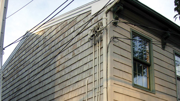

Let’s try to visualize the previous statements by working through a potential job activity on an older house.
There is no requirement for overcurrent protection ahead of the service conductors; therefore, the service disconnecting means is generally placed at the end of the service conductors.
Suppose you use both types of circuits; one circuit is protected according to Art. 240, and a second is protected according to Art. 230. The location is a city dwelling. One circuit is a service cable connected to the electric utility service drop, which supplies the electric utility meter and then runs inside the house and connects to the service disconnect. The other circuit is a service type cable used as a feeder that supplies the garage. Both circuits are located outdoors, run in service-entrance cable, and mounted on the exposed wood surface of the structure (Photo).
Now suppose these circuits need to be moved due to a siding repair job. If an untrained worker attempted to remove old rusted 2-hole support clips that fastened each cable to the wooden surface of the structure — and the claw of his wooden hammer and the cable support clip caused a short circuit in the cable that was about 12 in. from the worker’s face — what would happen?
Typically, the short circuited service cable supplying the house would likely create a large ball of flame. This short-circuited service cable may also be slow to de-energize and could continue to burn for a period of time. However, the short circuited service cable supplying the garage would likely de-energize quickly and hopefully cause only a medium-sized spark that quickly subsided.
The lesson learned from this hypothetical scenario is that identical overcurrent devices provide different types of overcurrent protection, simply by where they are physically placed within the circuit — and that placement substantially alters the risk of injury to a worker. Training electrical workers to see the real safety differences between overcurrent protection and overload protection should provide a deeper comprehension of safe work practices and procedures.
