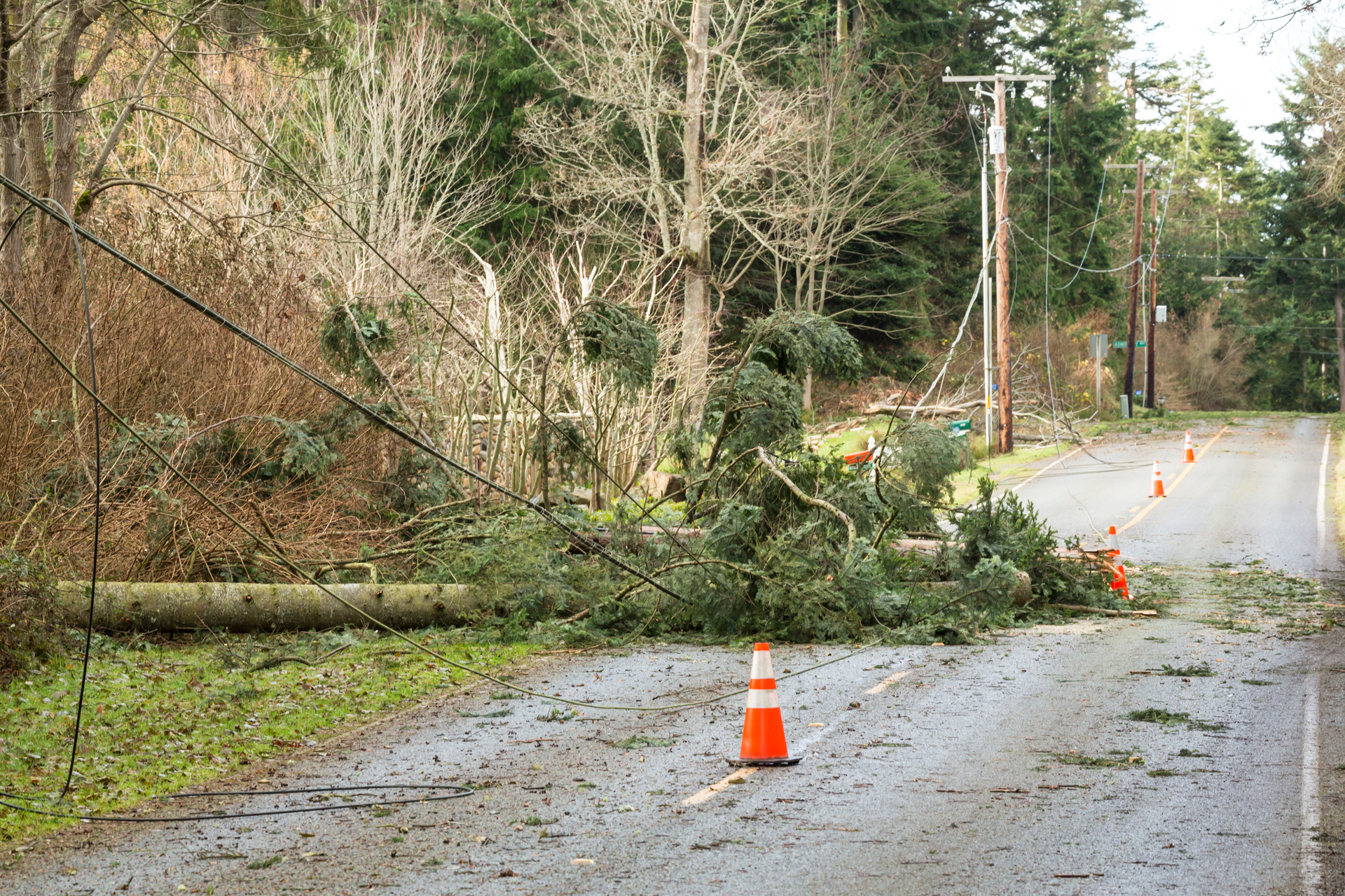

  4. Beware of downed lines. On route during a service call, electricians may encounter a downed wire blocking a road. If they come across such a situation, they should assume the line is live, call 911, and find an alternative route. They should never get out of their car or move the power line or they could risk being electrocuted.
