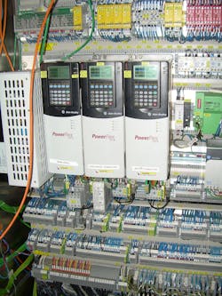

Because of regulatory, technology, and cultural changes, electrical workers are better protected today than they were just a few years ago. However, the mass of information available and complexity of equipment can be confusing (Photo 3). Here is an overview of the safe electrical work practices you should follow to stay safe. Of course, always follow company procedures as well.
- Assess the risk. The two primary concerns regarding electrical hazards are electric shock and burn (review NFPA 70E, Standard for Electrical Safety in the Workplace). When assessing any risk, consider the likelihood of an incident occurring and — should it occur — the possible severity of the injury or damage to health. Documenting the risk assessment is a must. Most organizations use a job safety analysis (JSA) or job hazard analysis (JHA) to plan and conduct all work. Job safety planning for electrical tasks is often not fully addressed in existing JSAs or JHAs. Consider revising these documents to properly address shock and burn, or use a separate electrical job safety plan. Arc flash warning labels provide minimum requirements. Take additional precautions when needed.
- Select and inspect personal protective equipment (PPE). Insulating rubber gloves must be inspected daily before use. Perform a visual inspection, looking for signs of physical damage, dates within compliance, and pass a field air test. Make sure the leather protectors are free from physical damage and of the correct length and glove size for the rubber gloves being used. Arc-rated clothing must have an ATPV rating equal to or greater than the incident energy on the arc flash warning label. Refer to NFPA 70E for additional PPE that must be used, such as hearing protection, hard hats, leather footwear, safety glasses, and other items as needed.
- Establish checklist. Before operation of electrical equipment, including opening doors for access, certain items for normal operation of equipment must be verified. For example, the equipment must be installed properly. Perform a visual inspection, and refer to drawings (if necessary). Verify the equipment has been properly maintained by reviewing maintenance records.
- Set up a barricade. The objective is to prevent other persons from receiving burns or being shocked. The Limited Approach Boundary is based on voltage levels taken from tables found in NFPA 70E. A shock hazard is considered to exist within this boundary. An Arc Flash Boundary is where the incident energy levels drop to the onset of a second-degree burn. Because people must be protected from both shock injury and arc flash burns, a physical barricade is set up at the Arc Flash Boundary or the Limited Approach Boundary, whichever is greater.
- Follow safe work practices to do the work. Establishing an electrically safe work condition is always the best option. Follow the steps of your hazardous energy control (electrical lockout/tagout) procedure to create an electrically safe work condition. Refer to the definition of "Working On" in NFPA 70E to help determine the need for an Energized Electrical Work Permit. Repair work requires this document ― which includes using an insulated screwdriver to tighten a terminal screw. Always de-energize if possible, know the equipment conditions considered necessary for normal operation, and follow your organization’s safe work procedures. Above all, exercise electrical common sense. Humility is always the biggest part of electrical safety. If there is any doubt, stop work and ask for help. Take refresher training courses on electrical safety and provide input to your company electrical safety policy. Be an electrical safety champion for your organization.
