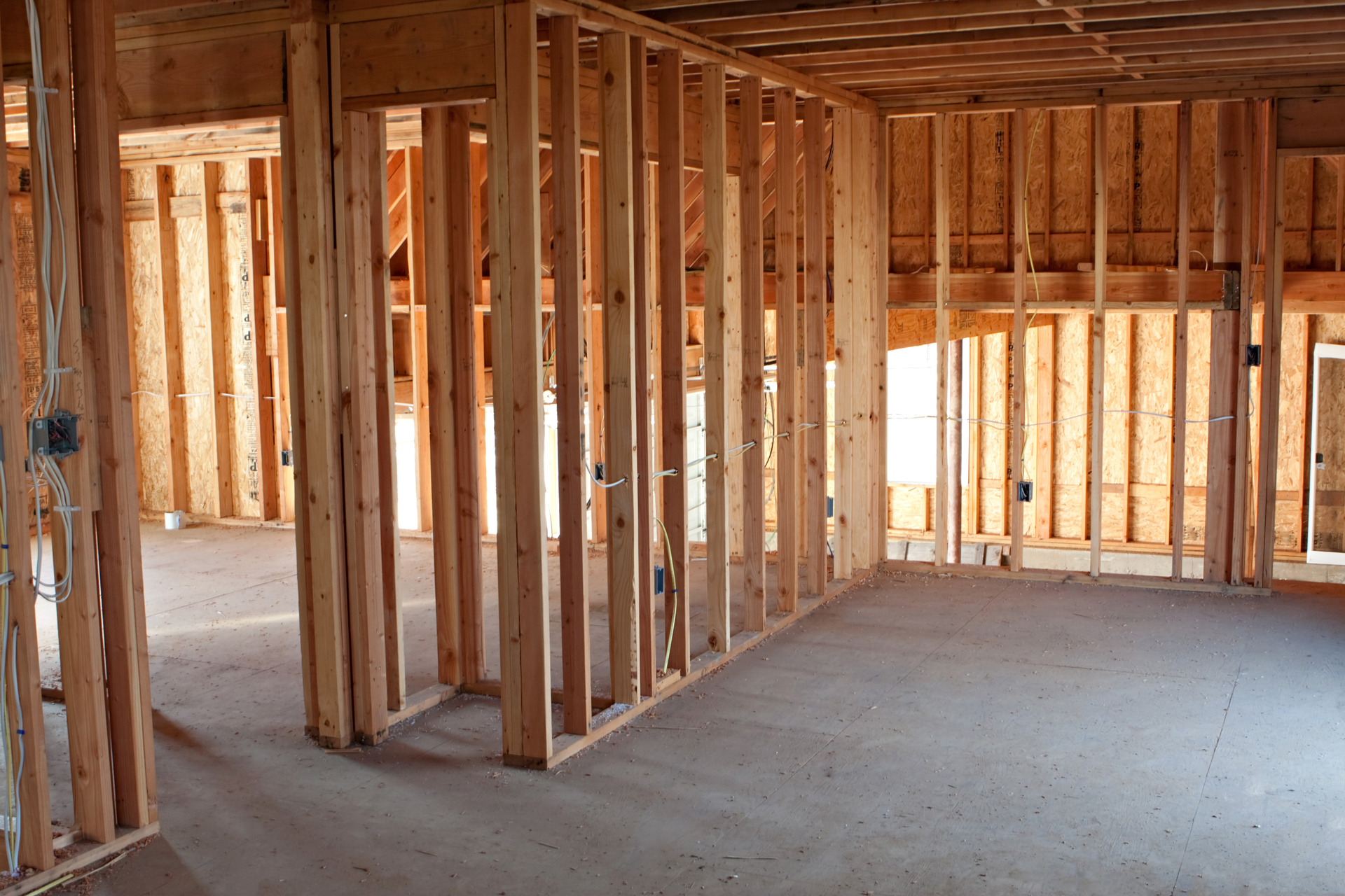

Non-metallic (NM) sheathed cable is one of the essential wiring methods found in Chapter 3 of the National Electrical Code (NEC) — see Art. 334. NM cable is used by electricians for wiring single-family dwellings, multifamily dwellings along with their attached or detached garages and storage buildings, mixed-use buildings, and light commercial applications. NM cable has a thermoplastic PVC-coated sheathing/jacket that provides electricians just the right amount of flexibility to pull it through studs, joists, and walls. It also has moderate abrasion resistance.

You can use it here
Type NM cable is permitted for exposed and concealed work in normally dry locations; it cannot be used in wet or damp locations (see Sec. 334.10). When used in exposed work applications, it must not be subject to physical damage. It may be installed or “fished” in the air voids of masonry block or tile walls. When NM cable is used in structures other than dwellings (non-residential), it must be concealed in walls, floors, or ceilings that provide a thermal barrier of material that has at least a 15-min fire rating (e.g., ½-in. drywall), as identified in listings of fire resistance and their rated assemblies.
