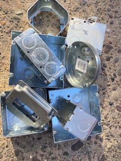

Improperly sized junction or device boxes can cause damage to conductors and create unintentional arcs between those damaged conductors. Table 314.16(A) and (B) is one of the most important guides in the NEC; we use it for sizing and selecting the proper metallic (sheet metal) device or junction boxes used in dry location, residential, commercial, and light industrial applications necessary to:
  • Protect combustible building materials from arcs.
  • Make splices for branch-circuit conductors and feeders.
  • Transition raceways or wiring methods from one method to another.
  • Support and protect electrical equipment and devices or utilization equipment.
Section 314.15 also covers installation requirements and design specifications for electrical junction boxes and fittings. For example, device or junction boxes used outdoors shall be listed for wet or damp locations; in other words, they must be constructed for the application and environment in which they are installed. The NEC does not contain a table for conductor fill for plastic or nonmetallic boxes and junction boxes. Manufacturers must durably and legibly mark the volume of the box on the device. Typically, you find this information stamped on the back of the device or box. Plaster rings and extension rings can be used to expand the volume of a box.
