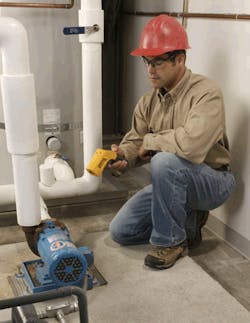

Don't just take a motor out of the box, throw it in place, and hope for the best. Before putting a motor into full operation, take insulation resistance readings from phase-to-phase and phase-to-ground. Measure the insulation resistance of the windings using an insulation multimeter to determine what a good reading is. In addition, measure the starting and running amperage, the running voltage, and the leg-to-leg balance.

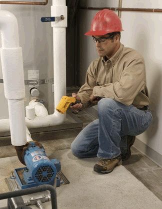

Measure the temperature at first startup (unloaded, loaded) and after a period of use. A motor may run hot because it's been used hard, is in a high-temperature area, or has a problem. Without knowing its normal temperature, it's difficult to tell which is the case. It's nice to know whether motors are running hot or not. A lot of times, you won't see any problems until the heat really builds up. For example, the inside temperature near the glass tempering ovens in my plant in the summertime is normally about 130°F.
You should also measure temperature using an infrared thermometer or a thermocouple connected to an insulation multimeter. It's good to compare results between the various methods.
