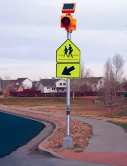

One application for solar-powered traffic devices is this flashing beacon assembly at a pedestrian crossing, which is located in a rural area.
