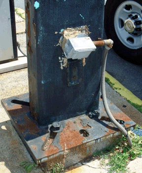

Lack of Support
This receptacle box is located on the bottom portion of a sign support structure. Let’s start by pointing out the fact that there is no support for this piece of flexible metal conduit, the angle connector, or the short conduit nipple. It’s also pretty obvious the lack of support at the receptacle box allowed the box to pull away from the metal structure. Instead of properly supporting the box and conduit after the fact, someone thought it would be better to fill the gap with a bunch of clay or sealant. What a mess!
We can also point out the use of an improper receptacle cover at this location. As per 406.9(B)(1), “15A and 20A, 125V and 250V receptacles installed in a wet location shall have an enclosure that is weatherproof whether or not the attachment plug cap is inserted.” This receptacle would also have to be protected by a GFCI in accordance with 210.8(B)(4). In addition, as noted in 406.4(A)(6), “weather-resistant receptacles shall be provided where replacements are made at receptacle outlets that are required to be so protected elsewhere in this Code.”
