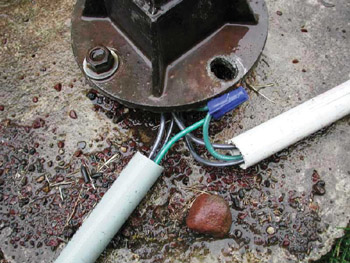

GOT A LIGHT?
This walkway lighting system must have been installed by someone who wasn't familiar with the accepted installation methods. Laying open nonmetallic conduit of this type with energized and exposed supply conductors in this manner doesn't show any knowledge of electrical safety or Code requirements. The proper way to supply this lighting unit would have been to bury underground conduit runs to depths required by 300.5 and extend them into the bottom of the pole where the splices would be accessible. See 410.15(B) for a list of the six requirements you must meet when installing metal poles to support luminaries (lighting fixtures) and serve as a raceway to enclose supply conductors.
