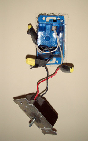

The headline for this piece, which was taken from MAD magazine's tagline for its “poster boy,” Alfred E. Neuman, most closely expresses my first reaction to this Photo. I mean someone did this on purpose for real?
The use of flexible lamp cord (aka, zip cord) as a general wiring method is forbidden by a couple of Code rules. First, 310.13 clearly specifies the types of conductors that are permitted by the Code for use as general wiring (i.e., branch circuits, feeder, and service conductors). Needless to say, lamp cord is not an option among the list of approved conductors shown in Table 310.13.
Additionally, there are the requirements given in 310.5 (Minimum Size of Conductors). These rules state that copper conductors must be no smaller than 14 AWG and aluminum conductors no smaller than 12 AWG. The copper conductor in this particular installation was only 16 AWG.
Lack of connectors for the “wiring method” where it enters the box is contrary to the rule in 314.17(C), which says, “In all instances, all permitted wiring methods shall be secured to the box.”
There are also concerns for the requirements given in Art. 400 (Flexible Cords and Cables), which have not been satisfied, one of which states that flexible cords may not be used as was done here (400.8). Part (2) of 400.8 says such cords and cables may not be used, “Where run through holes in walls, structural ceilings, suspended ceilings, dropped ceilings, or floors.”
There are other violations we could cite, but to do so would belabor the point. The salient point is that all Code rules are important. One violation constitutes non-compliance. Your goal on any installation should be zero defects.
This installation photo was contributed by Pierre Belarge, president of Electrical Training Solutions in Elmsford, N.Y. Belarge and an International Association of Electrical Inspectors (IAEI) certified inspector.
