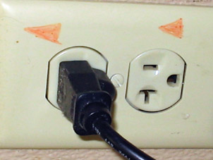

Tony Rampacek, manager — technical support, training and knowledge management, PARTech, Inc., Boulder, Colo., submitted this picture taken by one of his field representatives.
The company he works for installs and provides phone and field service for point-of-sale (POS) equipment in fast food restaurants. Its requirements state that the POS system must be connected to an isolated ground circuit to minimize the amount of noise the equipment may see. Such receptacles are orange in color most of the time, but the true identification is the delta symbol on the device.
“One of the common questions that comes up during our phone troubleshooting sessions is whether or not the equipment is plugged in to a receptacle with a triangle (delta) symbol on it,” Rampacek wrote. “After one such phone conversation, our local field rep found this interesting marking technique when visiting the customer's site. Seems as if a little creative art was performed on this receptacle.”
The Code covers isolated grounding type receptacles in 406.2(D). They're permitted for use only with grounding conductors that are isolated in accordance with 250.146 (D). The issue is also covered in 250.96(B). And see 250.119 for permitted methods of identification for equipment grounding conductors.
