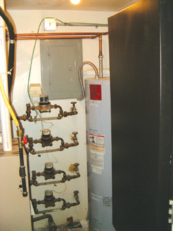

An apartment maintenance technician recently asked Roger Zieg, owner of Zieg Electric in Council Bluffs, Iowa, to check out this service panel. The technician said another contractor told him it was okay to put the water meters below the panel because “…. there's a 2 × 4 header under the panel.” So much for dedicated electrical space, huh? There is also an issue with the hidden 90° flex connector running from the panel to the water heater.
This is a clear violation of 110.26, Spaces About Electrical Equipment, which in part states, “Sufficient access and working space shall be provided and maintained about all electric equipment to permit ready and safe operation and maintenance of such equipment.” This working space shall “comply with the dimensions of 110.26(A)(1), (A)(2), and (A)(3) or as required or permitted elsewhere in this Code.” In addition, 110.26(A)(1) states, “The depth of the working space in the direction of live parts shall not be less than that specified in Table 110.26(A)(1) unless the requirements of 110.26(A)(1)(a), (A)(1)(b), or (A)(1)(c) are met. Distances shall be measured from the exposed live parts or from the enclosure or opening if the live parts are enclosed.”
