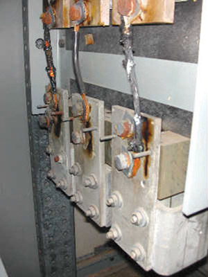

JUST TRY TO BLOW THIS “FUSE”
Doug Kidd, P.E., Kincaid*Bryant, Lynchburg, Va., found this installation recently while designing a chiller replacement at a state college. He noted that the original installation was completed in 1985 as a part of a major building renovation. The design used a 2,000A high-pressure contact main switch in the switchboard as the building service disconnect. “Maybe the electrician was in a hurry to get temporary power to the building,” Kidd wrote.
In addition, he noted that only three parallel sets of 500 kcmil were used for the service lateral. “That's all the electrician installed,” he said. “Needless to say, we advised the owner to immediately replace the ‘fuses,’ and we added a new service lateral to the existing design.”
These wires are surely not devices — they're not even solid wires. Per 240.2 of the 2005 NEC, a current-limiting overcurrent protective device is “a device that, when interrupting currents in its current-limiting range, reduces the current flowing in the faulted circuit to a magnitude substantially less than that obtainable in the same circuit if the device were replaced with a solid conductor having comparable impedance.”
