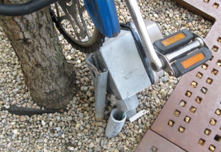

    Bike Kickstand with a Potential Extra Kick
    In this city street location, people are using the trees adjacent to the sidewalk as a bike stand. As you can see in this close-up photo, the bike pedals are causing severe damage to this electrical box. Note the exposed conductors showing between the nonmetallic tubing and the box connector. This situation could easily lead to an electrical accident where the entire bike could become a current-carrying conductor.
    It’s obvious this equipment is installed with a lack of proper protection from physical abuse. In addition, if these conductors are routed through ENT, then we could cite a violation of 362.12. ENT shall not be used for direct earth burial; where exposed to the direct rays of the sun, unless identified as sunlight resistant; or where subject to physical damage.
