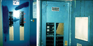

CARDBOARD BLANKS AND INVISIBLE INK
This is a problem I see all too often. How hard can it be to properly identify and label circuits? And who thinks cardboard is equivalent to a piece of metal when it comes to protection?
See 110.22, and the new 408.4, “Every circuit and circuit modification shall be legibly identified as to its clear, evident, and specific purpose or use. The identification shall include sufficient detail to allow each circuit to be distinguished from all others. The identification shall be included in a circuit directory that is located on the face or inside of the panel door in the case of a panelboard, and located at each switch on a switchboard.”
As per 408.7, “Unused openings for circuit breakers and switches shall be closed using identified closures, or other approved means that provide protection substantially equivalent to the wall of the enclosure.”
