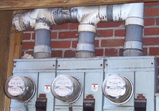

EVEN DUCT TAPE CAN'T SAVE THIS INSTALLATION
The use of duct tape isn't the only problem with this installation. Check out that unique raceway arrangement. “All I can think of is the Three Stooges routine, ‘The Plumbers,’ where Curly says, ‘Hey Moe, these pipes is full of wires,’” wrote submitter William R. Jennings, Jr., P.E., a consulting engineer in Forest, Va. Jennings ran across this installation in Blacksburg, Va., while performing a study of the electrical systems for an apartment building. He added, “It was a unique application for sanitary piping and fittings. I wonder how the contractor got the wires through the tees? I suppose that explains why it cracked and had to be repaired with duct tape.”
This installation violates the requirements of 230.43, Wiring Methods for 600 Volts, Nominal, or Less, and 230.44, Cable Trays.
