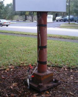

SHODDY SIGN WIRING
An electrician secured an electrical permit to install a time clock for this new sign. The circuit leading up to the base of the sign was there prior to this installation and had been used to feed an older sign in the same location. Although the electrician had only contracted with the property owner to install the time clock, the permit still covered the entire circuit. The company that installed the new sign may have hooked it up in this manner, but the authority having jurisdiction (AHJ) figured the best way to resolve the situation was to fail the job. The installation violates the requirements of 600.5(C)(1), (C)(2), and (C)(3).
