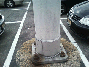

A Pole with No Hole
Trust me when I say the view from this side of the pole is the same as the others. The question we need to ask ourselves is what happened to the handhole on this luminaire pole? Was it missing from the start, or did it disappear during a modification process? Whatever the reason, the lack of a handhole is a violation of 410.30(B) of the 2011 NEC.
As noted in 410.30(B)(1), “A pole shall have a handhole not less than 50 mm × 100 mm (2 in. × 4 in.) with a cover suitable for use in wet locations to provide access to the supply terminations within the pole or pole base.” An Exception states no handhole shall be required in a pole less than 8 ft tall. However, this pole greatly exceeds that height limit. Another Exception says no handhole shall be required in a pole that is 20 ft or less in height above grade, provided it has a hinged base. It’s obvious from the photo this pole does not have a hinged base.
