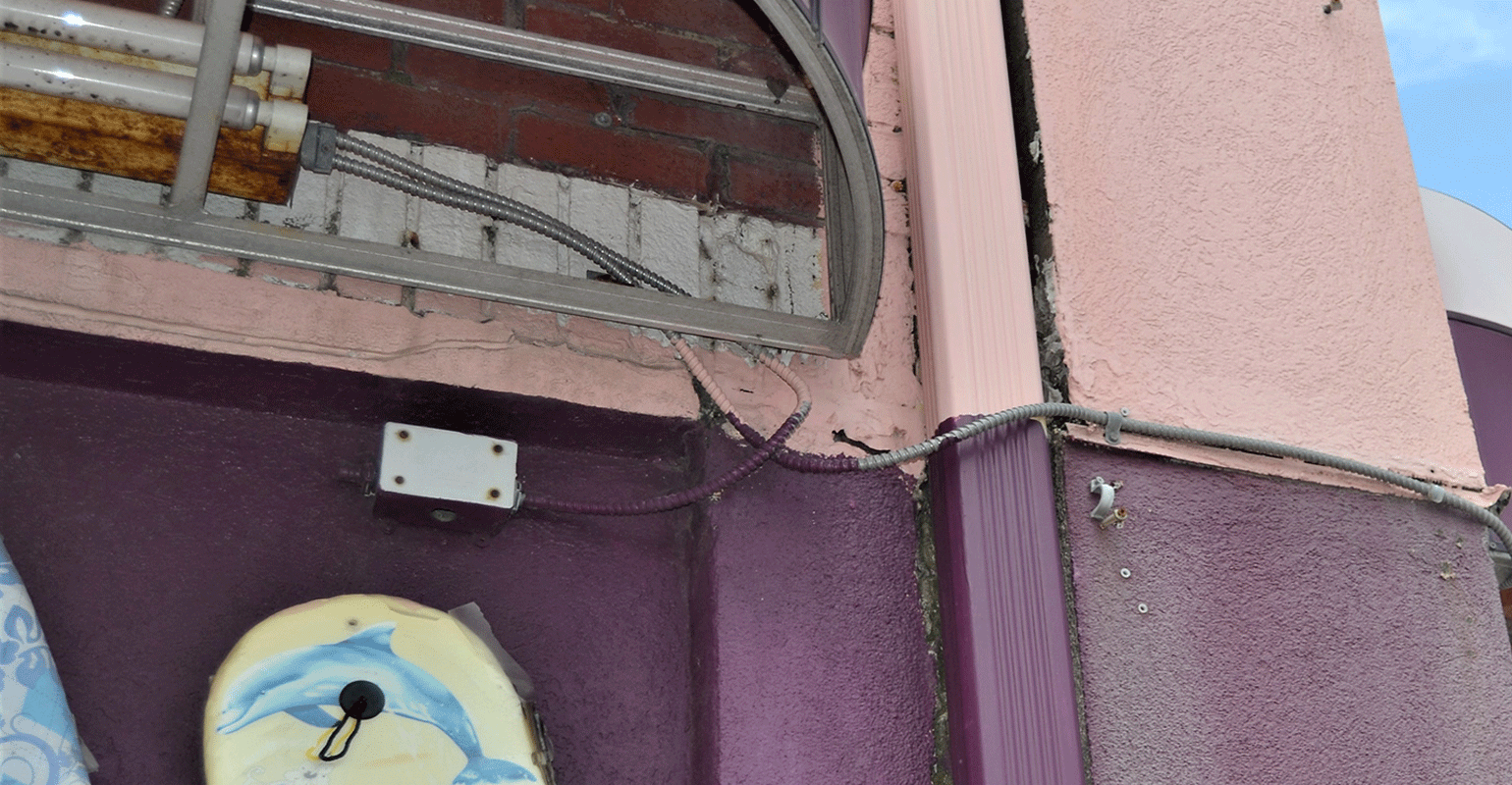

A close look at the wiring under this exterior awning reveals MC cable was used as a wiring method for this outdoor wet location. Section 330.10(A)(11) does permit certain types of MC cable to be used in wet locations. For use in wet locations, the MC cable must have a corrosion-resistant jacket over the metal covering and meet any of the following conditions: A) The metallic cable covering must be impervious to moisture; B) A moisture-resistant jacket must be provided under the metal covering; C) The insulated conductors in the cable must be listed for wet location use. The commonly used interlocked metal tape-type of MC cable that was installed here does not meet all those requirements. MC cable with an overall nonmetallic covering is available and would be a better cable wiring method option here. Another concern is the amount of cable supports. Section 330.30(B) requires cables with four or less conductors of size 10 AWG or smaller to be secured within 12 in. of each cable termination. Another problem is some of the bends in the cables are very tight and appear to violate the bending radius requirements spelled out in Sec. 330.24. Making bends that are too tight can damage the cable jacket and the insulation on the conductors inside the cable.
