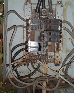

    GET A GRIP
    Darryl Dempsey, chief electrical inspector, Hillsborough County, Fla., discovered this installation while investigating a complaint lodged by the local power company. At first glance, it's apparent that the severely deteriorated main panel needs to be replaced. The 10 AWG wire's termination on a double-pole, 70A breaker may be a clear violation, but the most alarming part of this installation is the use of vise grip pliers to terminate the neutral. Note how the vise grip rests on top of the conductor. The circuit was operational and served a travel trailer some 200 ft away.
    Although this violation isn't specifically noted in the Code, it's covered under the more general requirements of 110.2, which states that conductors and equipment required or permitted by the Code are acceptable only if approved. Its accompanying Fine Print Note directs you to 90.7 Examination of Equipment for Safety and 110.3 Examination, Identification, Installation, and Use of Equipment.
