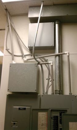

A Feast of Plenty
Heath Ward, a journeyman electrician/foreman, discovered this cornucopia of connectors, smorgasbord of support problems, and mix of violations in a convenience store in Dallas while disconnecting power to one area of the store for a remodel project. I’ll begin by pointing out the use of plumbing elbows incorrectly used with this PVC. Those short white elbows may be good for flowing water but are really bad for pulling wires. Section 110.8 informs us that only recognized wiring methods are included in the Code. This does not include plumbing fittings. The next violation is the use of EMT connectors on the PVC pipe and the MC cables connected to the top of the panel. This violates Sec. 300.15, which requires wiring methods to be used with fittings designed and listed for the specific wiring method installed. This could also create bonding and grounding problems for those metal cable jackets. The next violation is the lack of supports on the EMT and some of the PVC pipes. These pipes should be supported in accordance with 358.30 and 352.30, respectively, both of which require the pipe to be supported within 3 ft of the enclosure to which it is connected.
