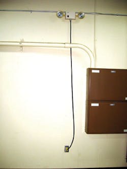

STRETCHED A BIT TOO FAR
“Ironically, the U.S. government contractor who maintained this building stated that an emergency light was required to comply with the NEC,” says Eric G. Lemmon, principal engineer, ULA Delta II Facilities Engineering, Denver. “I have found dozens of retrofitted emergency light units installed with EMT to surface extension boxes at wall receptacle locations. It seems that not every installer has read the requirements of 700.12(F).”
I couldn't agree with you more, Eric. As per a portion of 700.12(F), “Unit equipment shall be permanently fixed in place (i.e., not portable) and shall have all wiring to each unit installed in accordance with the requirements of any of the wiring methods in Chapter 3. Flexible cord-and-plug connection shall be permitted, provided that the cord does not exceed 900 millimeters (3 feet) in length. The branch circuit feeding the unit equipment shall be the same branch circuit as that serving the normal lighting in the area and connected ahead of any local switches. The branch circuit that feeds unit equipment shall be clearly identified at the distribution panel. Emergency luminaires (illumination fixtures) that obtain power from a unit equipment and are not part of the unit equipment shall be wired to the unit equipment as required by 700.9 and by one of the wiring methods of Chapter 3.”
