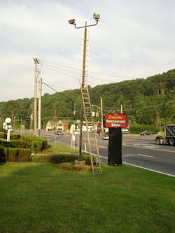

Now That's What I Call a “Git-R-Done” Job
There's no doubt this installation would make Larry the Cable Guy proud. Holy smokes! Although there is no electrical Code violation present in this photo, the persons responsible for this travesty fail to comply with the common sense clause that comes with joining the human race. But hey, at least it looks like they had a Boy Scout or sailor tie the knots on the rope.
While this installation might cause you to laugh initially, that feeling is soon replaced by concern and fear for the person who has to climb up this ridiculous work platform. Because electrical installers and maintenance personnel are often required to work in the overhead space of high-bay commercial occupancies or outside on lighting poles, this photo should cause everyone to reflect on the methods and procedures they use when working aloft.
Are you considering all pertinent Occupational Safety and Health Administration (OSHA) regulations related to such activities? Do you have the requisite equipment, such as harnesses, lifts, or ladders at your disposal (when appropriate)? Have your employees been trained on the proper use of such equipment? Have you documented such training? Can you prove your employees are qualified personnel?
Take the time to look into this matter and ensure you're conducting work aloft in a safe and secure manner. Then say a prayer for the guy who has to climb this monstrosity.
