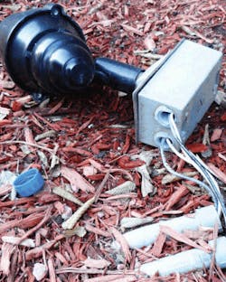

I found this accident scene in front of a well-known coffee shop. The damage was caused by a snow plow
June 22, 2011
Plowed Down During a Storm
I found this accident scene in front of a well-known coffee shop. The damage was caused by a snow plow. The nonmetallic raceways used for this installation do not meet the requirements of 314.23(F) for raceway-supported enclosures, with devices, luminaires, or lampholders. This section of the Code states, “An enclosure that contains a device(s), other than splicing devices, or supports a luminaire(s), lampholder, or other equipment and is supported by entering raceways shall not exceed
1,650 cm3 (100 in.3) in size. It shall have threaded entries or have hubs identified for the purpose. It shall be supported by two or more conduits threaded wrenchtight into the enclosure or hubs. Each conduit shall be secured within 450 mm (18 in.) of the enclosure.”
