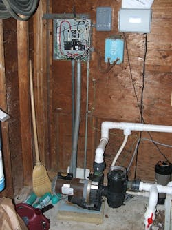

Poor Pool House Planning
I’m not sure this layout was a good idea. Leaving the panelboard uncovered is definitely a bad idea. The missing panelboard cover creates a shock hazard due to the energized parts being exposed instead of being guarded against accidental contact. Section 110.27(A) requires a completely secure enclosure.
Installing the pool motor and plumbing pipes in this spot has made an already crowded area a dangerous area as well. Where would an electrician stand while working in this panelboard? He or she would need to overextend their reach or stand uncomfortably and off-balance. Either way creates an extra level of danger for the electrician. The working space in front of this panelboard must be kept clear to the depth, width, and height dimensions required by Sec. 110.26(A).
The rusted flexible metal conduit (FMC) on the right side of the panelboard is a good indication that this area is probably being used to store pool chemicals and would now be considered a corrosive environment as specified in Sec. 680.14(A). Section 680.14(B) spells out which wiring methods are permitted in this type of location, and FMC is not one of those permitted methods.
