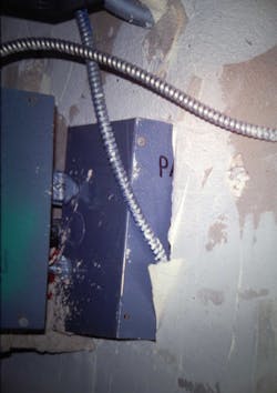

    The Blueprints Made Me Do It
    I think someone may have misread the blueprints on this job. Somehow, this junction box ended up right in the middle of this wall. In fact, it appears as though the wall was constructed right around the box. Maybe it was the electrician, or maybe it was the carpenter who made the mistake. But no matter who did it, it’s still classified as a Code violation — because it’s virtually impossible to access the wiring in this box without having to bust open the wall.
    Section 314.29 states, “Boxes, conduit bodies, and handhole enclosures shall be installed so that the wiring contained in them can be rendered accessible without removing any part of the building or, in underground circuits, without excavating sidewalks, paving, earth, or other substance that is to be used to establish the finished grade.” We could also say this installation violates 314.20, which requires boxes employing a flush-type cover or faceplate installed in walls or ceilings with a surface of concrete, tile, gypsum, plaster, or other noncombustible material, to be “installed so that the front edge of the box, plaster ring, extension ring, or listed extender will not be set back of the finished surface more than a ¼ in.”
