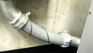

How well do you know the Code? Think you can spot violations the original installer either ignored or couldn’t identify? Here’s your chance to moonlight as an electrical inspector and second-guess someone else’s work from the safety of your living room or office. Can you identify the Code violation(s) in this photo?

We had three winners this month: Brandon McCoy, foreman, G&G Systems, Henderson, Nev.; Larry Lowe, reliability engineer, Flint Ink, Huntington, W. Va.; and Bill Butler, estimator/project manager, Bayshore Electric, Inc., Daytona Beach, Fla. Each one of them had some interesting observations on this bird nest-filled conduit body — the best one being, “the feathers and twigs in this LB do not qualify as sealing material.”
The missing cover for the conduit body is a violation of 314.17(A) and 314.28(C). This exposes the cable to corrosion and deterioration (and even wild birds!), which is a violation of 300.6. As noted above, feathers and twigs do not qualify as an approved sealing material per 300.7. The conductor exiting the conduit body is now exposed and unprotected from physical damage, which is a violation of 300.4 and 300.5(D)(2). The open and exposed holes in the brick wall at both locations in this photo also create a potential fire hazard. The lack of approved fire stop materials at these locations also creates a violation of the requirements of 300.21. As is normally the case with these photos, we can also cite this installation for not being done in a neat and workmanlike manner (110.12).
