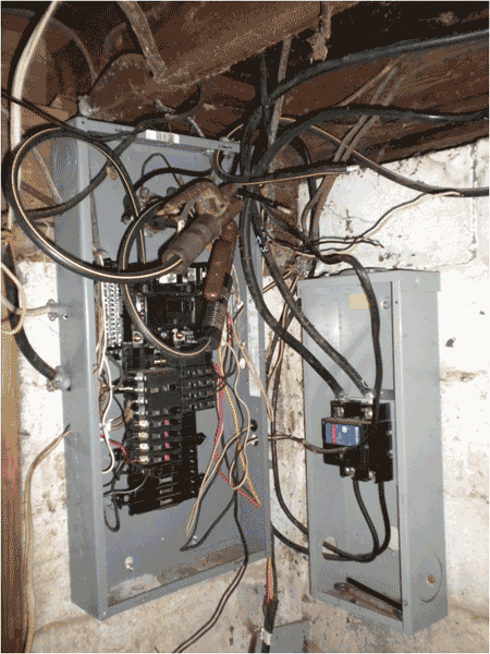

How well do you know the Code? Think you can spot violations the original installer either ignored or couldn't identify? Here's your chance to moonlight as an electrical inspector and second-guess someone else's work from the safety of your living room or office. Joe, who has a knack for finding shoddy electrical work, did the dirty work and found this mess. Now it's your turn to identify the violation.
Find the Answer
Al Hamer, a commercial supervisor/estimator with Advanced Electrical Technologies in Longview, Wash., submitted this beauty.
Wow! What a mess. We could spend a long time discussing everything that's wrong here, but let's start with loose and unsupported wiring, open and exposed energized systems, and installation methods that defy logic and safety. Let's just say nothing meets NEC rules at this location.
The requirements of Sec. 110.3 seem appropriate to review now.
"110.3 Examination, Identification, Installation, and Use of Equipment.
(A) Examination. In judging equipment, considerations such as the following shall be evaluated:
(1) Suitability for installation and use in conformity with the provisions of this Code
Informational Note: Suitability of equipment use may be identified by a description marked on or provided with a product to identify the suitability of the product for a specific purpose, environment, or application. Special conditions of use or other limitations and other pertinent information may be marked on the equipment, included in the product instructions, or included in the appropriate listing and labeling information. Suitability of equipment may be evidenced by listing or labeling.
(2) Mechanical strength and durability, including, for parts designed to enclose and protect other equipment, the adequacy of the protection thus provided
(3) Wire-bending and connection space
(4) Electrical insulation
(5) Heating effects under normal conditions of use and also under abnormal conditions likely to arise in service
(6) Arcing effects
(7) Classification by type, size, voltage, current capacity, and specific use
(8) Other factors that contribute to the practical safeguarding of persons using or likely to come in contact with the equipment.
"(B) Installation and Use. Listed or labeled equipment shall be installed and used in accordance with any instructions included in the listing or labeling."
