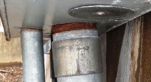

How well do you know the Code? Think you can spot violations the original installer either ignored or couldn’t identify? Here’s your chance to moonlight as an electrical inspector and second-guess someone else’s work from the safety of your living room or office. Can you identify the Code violation(s) in this photo?

Our two winners this month include: Brian Trumble, project manager, New Energy Service, Inc., Titusville, Fla., and Fred Schlosser, owner, eWire Electric Co., Winston-Salem, NC. Here’s a short recap of the violations they noted at the base of this pole.
Metal poles can be used as raceway to enclose supply conductors, but the handhole must have a cover suitable for use in wet conditions. The missing cover violates 410.30(B)(1).
Live parts 50V or higher are not guarded, because they are outside the enclosure. The exposed conductors violate the requirements of 110.27(A)(2). Section 300.4 could also be cited, as the conductors are now unprotected and subject to physical damage.
The conduit leading up to the bell box shall comply with 300.5(D)(4), which states: “Where the enclosure or raceway is subject to physical damage, the conductors shall be installed in rigid metal conduit, intermediate metal conduit, schedule 80 PVC conduit, or equivalent.” If the conduit is schedule 40 PVC, this would be a violation. Assuming the PVC is schedule 40, it is not guarded against physical damage. This is a violation of 352.12(C).
