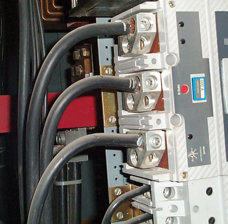

If you look closely, you’ll see that some fool used a folded-in-half fender washer to help fill in the extra space at the C-phase feeder conductor termination in this overcurrent protection device. In fact, even though you can’t see them, the other two phases are terminated in the same fashion. This isn’t a recognized method of installation and creates a serious hazard. At minimum, this installation violates the rules in 110.14, which states conductors of dissimilar metals can’t be intermixed in a terminal or splicing connector.
