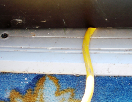

What's Wrong Here?
May 29, 2007
Hint: Power in a pinch
Find the Answer
Article 590 of the Code covers temporary installations. As per 590.4(H) Protection from Accidental Damage, “Flexible cords and cables shall be protected from accidental damage. Sharp corners and projections shall be avoided. Where passing through doorways or other pinch points, protection shall be provided to avoid damage.”
