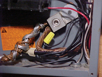

All of the feeder and branch-circuit.
Find the Answer
Robert McCullough, director of the Ocean County Construction Inspection Department, Toms River, N.J., correctly identified the following Code violations in this photo.
“110.14 Electrical Connections — improper connection of dissimilar metals; 110.14(A) — The terminal is not approved for more than one conductor, although it appears that the aluminum EGC doesn't even terminate in the lug; 408.20 — The installation requires a terminal bar; 250.12 — It looks like the paint wasn't removed from the panelboard enclosure to ensure good electrical contact; 250.8 — The screw attaching the lug appears to be a sheet metal screw; 250.119 — A bare EGC seems to be coming out of the yellow wire nut spliced to a black wire going to the lug. Because a washer is placed under the screw, the screw may be smaller than the hole in the lug and thus would not be a secure connection. Finally, the term ‘subpanel’ is not recognized in the NEC.”
