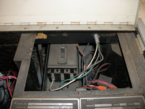

This photo was sent in by Chris Surowiec, a project manager – estimator for Lee's Electrical Contracting, Inc. in Baltimore.
The lack of a connector on the MC cable is a violation of 300.10. This section of the Code requires metal cables to be mechanically secured and connected to the enclosure in a manner that will provide electrical continuity. More importantly, connecting the green wire to the circuit breaker terminal creates a violation of 250.119, since wires with green insulation cannot be used as an ungrounded conductor on this 480V circuit.
Since there is no connector on the MC cable and the green wire is not being used as an equipment ground wire, this MC cable provides no effective ground fault current path in accordance with 250.118(10). This increases the shock hazard for an already dangerous situation, because the equipment supplied by this MC cable is not grounded and bonded in accordance with many other requirements of Art. 250, including, but not limited to, Secs. 250.4(A)(5) and 250.4(B)(4).
The use of the white wire as an ungrounded conductor for this MC cable is permitted by 200.7(C)(1), but only if it is reidentified with marking tape, paint, or other approved means to indicate such use.
