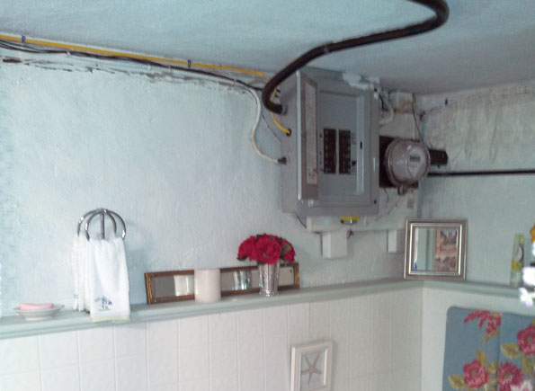

How well do you know the Code? Think you can spot violations the original installer either ignored or couldn’t identify? Here’s your chance to moonlight as an electrical inspector and second-guess someone else’s work from the safety of your living room or office. Can you identify the Code violation(s) in this photo? Note: Submitted comments must include specific references from the 2011 NEC.
Hint: A close shave

Shoving two wires under a screw terminal designed for only one wire is a great way to make a lousy connection. In fact, it creates a Code violation. The very last sentence in 110.14(A) tells us in a straightforward way that specially identified terminals are required for terminating more than one conductor. Nonetheless, when I pulled this receptacle out of the box, I discovered two white wires and two black wires mistakenly landed on terminals designed for only one wire. This would also be a violation of 110.3(B) since the installer ignored the instructions in the listing and labeling of this device. A better way to do this installation would have been to make a 3-wire splice for each circuit conductor and then connect the “pigtail” wire from each splice to the correct terminal on the receptacle. Ironically, this was how the equipment ground wire was correctly terminated for this device.
