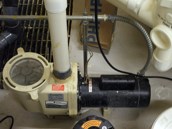

    The choice of wiring methods used for this swimming pool water pump motor leads me to believe the installer did not bother to read Sec. 680.21(A) of the NEC.
    Branch circuits for pool motors must be installed using rigid metal conduit (RMC), intermediate metal conduit (IMC), polyvinyl chloride conduit (PVC), reinforced thermosetting resin conduit (RTRC), or metal-clad (MC) cable listed for swimming pool use, as noted in 680.21(A)(1). On or within dwellings, Sec. 680.21(A)(2) permits EMT. Where flexibility is needed at the motor, 680.21(A)(3) permits the use of liquidtight flexible metallic conduit (LFMC) or liquidtight flexible nonmetallic conduit (LFNC). It does not, however, permit the use of flexible metal conduit (FMC) as was used for this installation.
    Inside a dwelling unit or its accessory building, 680.21(A)(4) permits any recognized Chapter 3 wiring method, including FMC. However, this installation was made at a community pool. Therefore, the use of FMC in this particular application is a violation. As an alternative, the installer could have used a cord and plug connection in accordance with 680.21(A)(5).
    I would also like to point out the excellent drainage provided in the floor, visible in the uper left of this photo. Section 680.11 requires you to provide enough drainage for water accumulation during normal operation and maintenance.
    The bonding foot lug on the motor appears as though it has been torn off the motor. This is a violation of 680.26(B)(6), which requires the motor to be bonded to all of the other components mentioned in 680.26(B)(1) through (B)(7).
