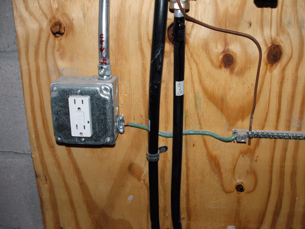

What’s Wrong Here? Hint: Funny Looking Service Disconnect
March 20, 2014
Hint: Funny looking service disconnect
Find the Answer
Section 250.94 of the 2014 NEC requires an intersystem bonding termination for bonding of other systems to be installed external to enclosures at the service equipment, metering equipment or building disconnecting means. Although the branch circuit supplying this receptacle and its enclosure are none of those things, it’s still a violation.
The intersystem bonding termination shall comply with the following:
1) be accessible
2) allow for connection of at least 3 bonding conductors
3) not interfere with opening of enclosures
4) be securely mounted and bonded to metallic service equipment or metering enclosures or be installed at one of these enclosures and bonded with a minimum 6 AWG conductor to the enclosure or GEC
5) be securely mounted and bonded to the building disconnecting means or be installed at one of these enclosures and bonded with a minimum 6 AWG conductor to the enclosure or GEC
6) The terminals must be listed for grounding and bonding.
According to the Exception, an intersystem bonding termination is not required for existing buildings. An accessible external means shall be permitted at service equipment and building disconnecting means by one or more of the following:
1) an exposed nonflexible service raceway
2) an exposed GEC
3) other approved means for externally bonding to the GEC, grounded  raceway or equipment.
