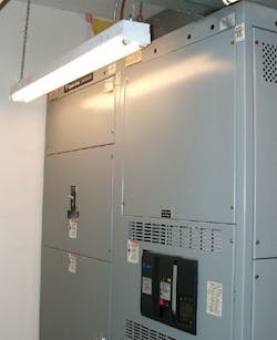

Our winners this month were: Robert M. Berndsen, an electrical designer for the GPD Group of Cleveland, Ohio; Alan Fraser, with DoD Facilities Engineering in Ft. Meade, Md.; and Samuel L. Biedny of Samuel L. Biedny Enterprises of Riverside, Calif. They were all able to correctly identify specific sections of the Code that were violated by this luminaire installation.
Section 110.26(D) requires illumination to be provided for the working space around switchboards, but this installer took it a little too far. The working space in front of this switchboard is now obstructed by the very same luminaire that was installed to make it “easier” to work on the equipment. Now workers must push the unit aside or duck underneath it when trying to remove some of the upper covers on the switchboard. Imagine accidentally smashing the fluorescent lamps while you were trying to remove those covers. What a mess!
This is a violation of Sec. 110.26(A)(3). The working space must be clear and extend from the floor to a height of 6½ ft above the floor or to the height of the equipment if it is greater than 6½ ft. There was plenty of room to install this luminaire higher, but, for some reason, the installer chose to put it right in his own way. Sure, the lighting is great, but it creates some other safety concerns that are unnecessary.
