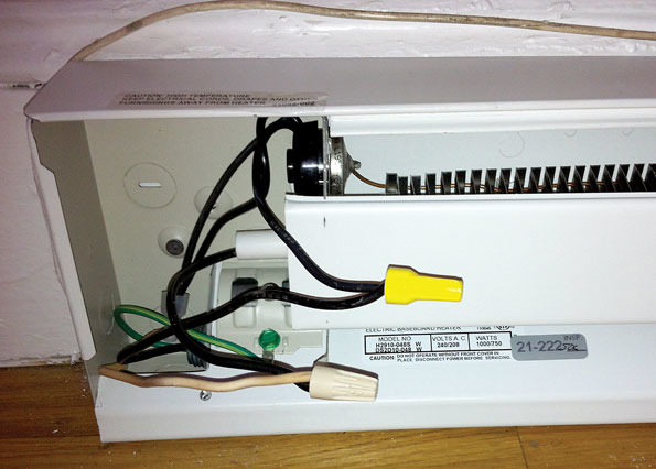

What's Wrong Here? Hint: A White Hot Heater

Hint: A white hot heater
