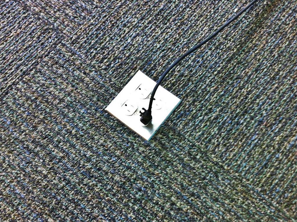

• What’s Wrong Here? Hint: Floor Plug Folly
    NEC rules on installing general-purpose type boxes and covers
    July 7, 2016
    Hint: Floor plug folly
    Find the Answer
    For receptacles installed in floors, Sec. 314.27(B) requires boxes to be specifically listed for this application. By the looks of this installation, the installer used a couple of “old work” style boxes with a stainless steel receptacle cover. This type of installation would be appropriate for wall applications, but not for floor applications. The Exception to this Code rule would permit the AHJ to approve other types of boxes where the receptacle was located in elevated floors of show windows, but this receptacle was installed in the middle of an office. Therefore, this Exception would not be applicable in this case.
    Sections 406.5(E) and (D) have requirements for receptacles that are installed “face-up” in countertops, work surfaces, seating areas, and similar locations. These sections each require assemblies that are specifically listed for that application. Those types of assemblies are equipped with bodies, and covers that provide much better protection from falling debris and liquids that could easily end up inside the receptacle.
    The bottom line is general purpose type boxes and covers are not appropriate for installation in floors.
