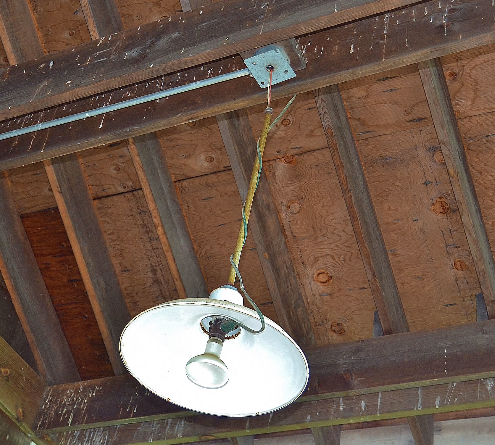

Improperly installed luminaire
Hint: Dangling like the sword of Damocles
Scroll Down to See the Answer
Don’t look up! You might get the scare of your life. This luminaire is precariously dangling by its wires! The fixture stem has become dislodged from the connection to the plate secured to the ceiling box, and now the wires are stretched and straining to keep this luminaire from crashing down to the ground or onto an unsuspecting person’s head.
Sec. 410.30(A) requires luminaires to be securely supported. Electrical wires are not an approved means of support.
It also appears there is no equipment grounding conductor (EGC) connected to this dangling luminaire, which would be a violation of Sec. 410.42 if the luminaire is no longer grounded and bonded. This lack of grounding and bonding could also pose a shock hazard to a person trying to service this luminaire if the ungrounded conductor energized the metallic canopy, and there was no path for fault current to open the branch circuit overcurrent device.
We can also see that someone installed a screw shell receptacle adapter into the lampholder of the luminaire. Section 410.90 states screw shell-type lampholders shall be installed for use only as lampholders.
