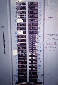

What's Wrong Here? Hint: A crowded house panel
How well do you know the Code? Think you can spot violations the original installer either ignored or couldn’t identify? Here’s your chance to moonlight as an electrical inspector and second-guess someone else’s work from the safety of your living room or office. Can you identify the specific Code violation(s) in this photo? Note: Submitted comments must include specific references from the 2017 NEC.
Hint: A crowded house panel.

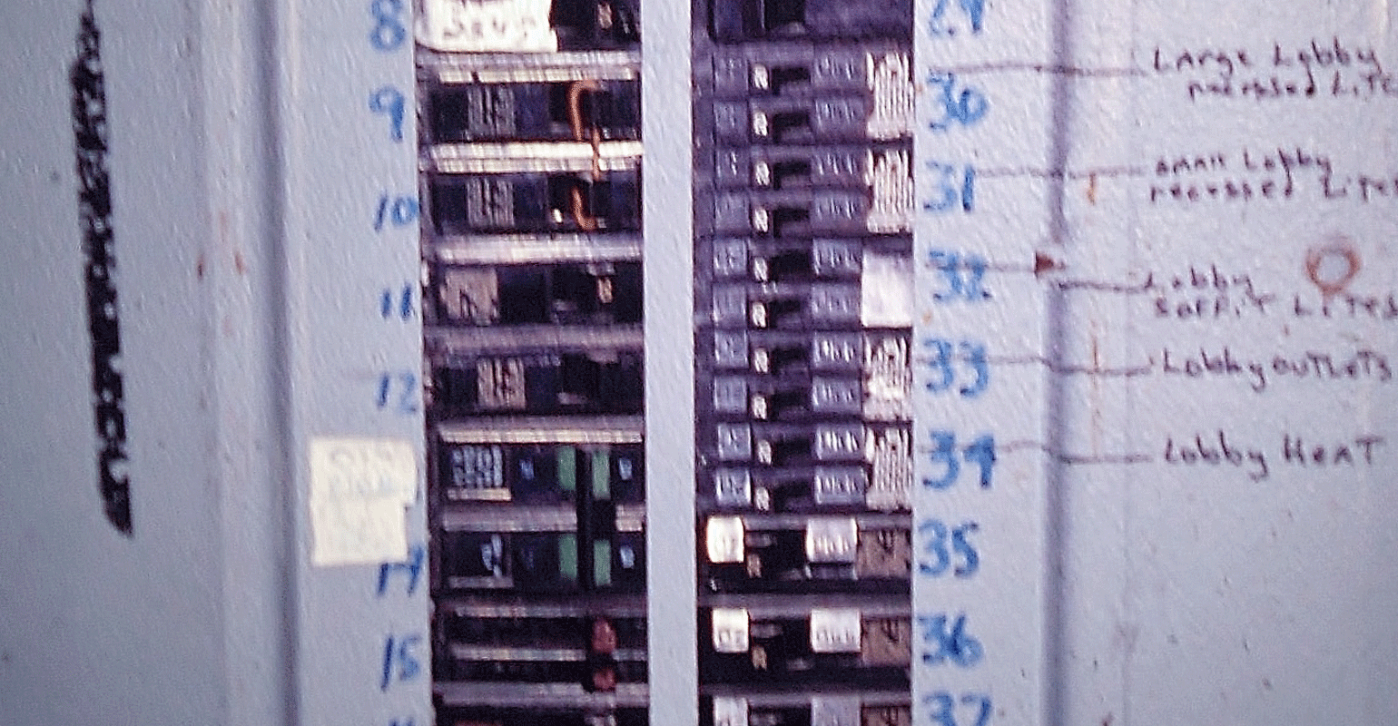

Our three winners this month were: Matt Barr, a reader from Shreveport, La.; Michael Norris, an instructor for the Boston Public Schools, Quincy, Mass.; and Steve Potter, a superintendent for Triple R Electric, Inc., in LaGrange, N.C. All three correctly pointed out the fact that this box needs a couple of knockout seals installed to be Code compliant.
Section 110.12(A) requires unused openings to be closed with a plug, plate, or other type of closure to provide protection equivalent to the wall of the box or equipment. Openings for mounting holes, vent holes, and other openings that are part of the equipment design and operation are not required to be closed. Keeping the box closed contains possible arcs and sparks inside, and prevents them from igniting adjacent combustible materials. It also prevents accidental contact with exposed live parts inside the box. Keeping the box closed can also help keep critters out. Mice and other small rodents or pests can enter through missing seals and cause damage by chewing wires or contacting energized live parts — neither of which works out well for the life of the equipment or the critters, for that matter.
