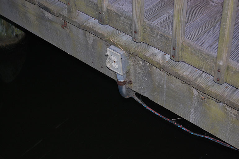

I spotted this broken receptacle box on the side of a pedestrian walkway over a small lagoon area. This is located directly over the water. You can see the cable feeding the receptacle is dangling below the walkway. This cable is just stubbed into a short piece of PVC conduit in the bottom of the box. I was not able to confirm the type of cable used, but my best guess is that the installer used UF cable.
The broken/missing cover is a violation of Sec. 406.9(B)(1). An extra-duty rated weatherproof in-use cover would have been an appropriate choice here. Using a weather resistant WR-type receptacle is also required by Sec. 406.9(B)(1) for this outdoor wet location.
I was not able to check for GFCI protection, but Sec. 210.8(B)(4) does require GFCI protection for a 15A, 125V rated receptacle in this location. Perhaps the GFCI protection was provided by a circuit breaker or through a GFCI-type receptacle installed ahead of this one.
The lack of supports on the UF cable is a violation of Sec. 225.21 and Sec. 230.51(A), which require support within 12 in. of connection to a raceway or enclosure and again every 30 in.
