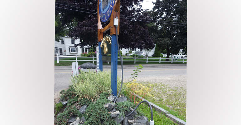

Hint: Lousy liquidtight installation
See the answer below.
Apparently, whomever installed this liquidtight flexible metal conduit (LFMC) did not believe in using support clips. I did not see one clip or other supporting means used anywhere on this installation. Per Sec. 350.30(A), LFMC must be securely fastened within 12 in. of each box or other conduit termination, and further supported and secured at intervals not exceeding 4½ ft. There are four exceptions to this general rule, but none of them are applicable to this installation. I’m not sure that burying LFMC under large rocks is a good idea either as it may violate Sec. 350.12(1), which prohibits LFMC from being used where it may be subject to physical damage. I suppose we could argue that this LFMC must also be listed and marked for direct burial in accordance with Sec. 350.10(3), since a portion of it is buried under those rocks.
