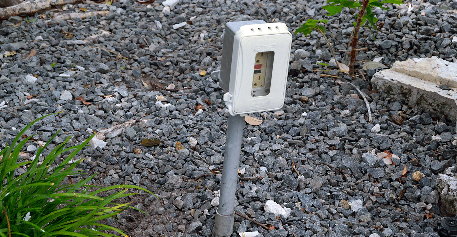

How well do you know the Code? Think you can spot violations the original installer either ignored or couldn’t identify? Here’s your chance to moonlight as an electrical inspector and second-guess someone else’s work from the safety of your living room or office. Can you identify the specific Code violation(s) in this photo? Note: Submitted comments must include specific references from the 2017 NEC.
Hint: I don’t “support” this type of installation

Jamming 12 AWG conductors into the same terminals with 3/0 conductors is not the best way to make a feeder tap. It’s probably a great way to end up with a loose and arcing connection. It also certainly creates a violation of Sec. 110.14(A), unless the terminals are specifically identified for this purpose. The terminals in this panelboard are not designed for this installation. Another problem can be spotted on the two 20A, 2-pole circuit breakers on the right side of the panel. The white wires connected to these breaker terminals do not comply with Sec. 200.7(C). Conductors with white insulation, where part of a cable assembly, can be used for ungrounded conductors, but only where the conductors are permanently re-identified for use as an ungrounded conductor.
