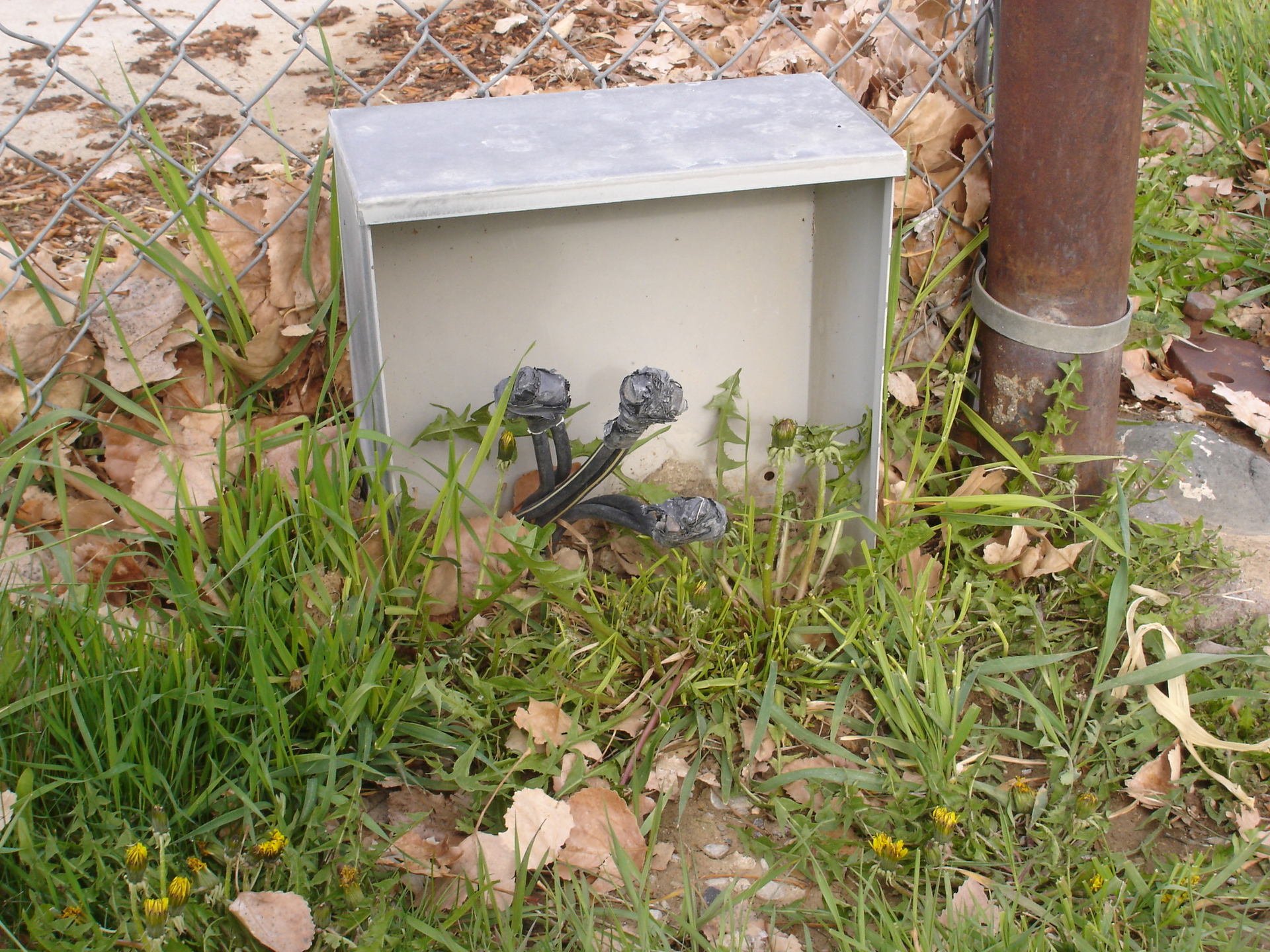

Jon Titus, an electronics consultant from Herriman, Utah, shared this photo with us. He says, “I found this connection near a tennis court in southern Utah.” As far as he could tell, the circuits were live. Great find, Jon, and thanks for sharing.
Somewhere along the way, the cover for this box went missing. Or, perhaps the cover was never installed in the first place. In either case, the installation does not comply with Sec. 314.25. Completed installations must include some type of cover for each box.
Upon closer examination of the splices, you may notice some tape missing from some of the wire connectors. This lack of insulating tape leaves energized conductors exposed where people and animals could be injured or killed by the circuit voltage. Section 110.27 requires live parts of electrical equipment operating above 50V nominal to be guarded against contact. A person cutting the grass or merely walking by these exposed energized conductors could be in real danger unless this situation is fixed.
