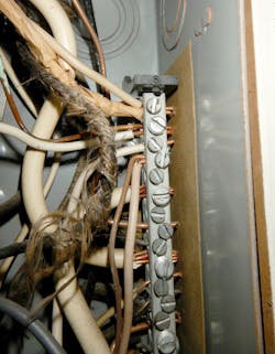

    Think you can spot violations the original installer either ignored or couldn’t identify? Here’s your chance to moonlight as an electrical inspector and second-guess someone else’s work from the safety of your living room or office.
    March 26, 2020
    How well do you know the Code? Think you can spot violations the original installer either ignored or couldn’t identify? Here’s your chance to moonlight as an electrical inspector and second-guess someone else’s work from the safety of your living room or office. Can you identify the specific Code violation(s) in this photo? Note: Submitted comments must include specific references from the 2020 NEC.
    Hint: Crazy AC wiring
    January Winners
    Our winners this month were: Jace Hilton, a building inspector in Layton, Utah; Fernando Bendeck, P.E., EXP, an electrical engineer in San Diego; and Wayne Cello, a reader from Leland, N.C. They all knew that neutral conductors cannot be “doubled-up” in terminals like the ones in the photo.
    Section 408.41 requires each grounded (neutral) conductor to terminate in the panelboard on its own terminal, which is not also used for another conductor. The exception would be for paralleled neutral conductors terminating in terminals identified for connection of more than one conductor, such as 2-barrel or 3-barrel lugs. Sometimes equipment grounding conductors (EGCs) can be doubled- or even tripled-up in one terminal when the manufacturer instructions permit this type of installation. Installing equipment grounding conductors in the same terminal with neutral conductors violates Sec. 110.3(B).
