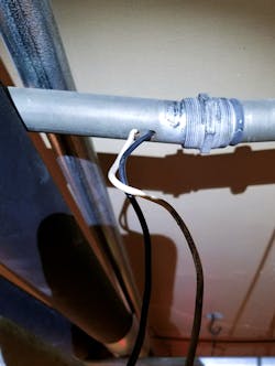

How well do you know the Code? Think you can spot violations the original installer either ignored or couldn’t identify? Here’s your chance to moonlight as an electrical inspector and second-guess someone else’s work from the safety of your living room or office. Can you identify the specific Code violation(s) in this photo? Note: Submitted comments must include specific references from the 2020 NEC.
Hint: PVC problems
March Winners
A big thanks to Mike Wellman, an employee with Perfection Group in Cincinnati, for sharing this photo with us. In his words, “This picture was taken at an old church that we are installing a VRF system at in Indianapolis. These wires were feeding a circuit in a basement classroom. We discovered them while pulling communication wires for our building automation system.”
Our winners this month were Lee Summers, a project manager for C Mechanical Services in Lancaster, Pa.; Al Gensitskiy, a reader from Hillsboro, Ore.; and Oscar Muñiz, an apprentice with IBEW Local 332 in San Jose, Calif. They knew running wires of AC circuits through individual openings of ferrous metal enclosures in this manner violates Sec. 300.20(B). They also knew that loose or missing EMT couplings can defeat any grounding or bonding required by Art. 250, while also violating Sec. 358.42. Running individual conductors without being installed as part of a Chapter 3 wiring method violates the requirements of Sec. 300.3(A). Running wires through holes drilled in EMT with no protection from sharp metal edges could result in damaged conductor insulation and, more importantly, arcing, sparking, and possibly a fire. A better option for this installer would have been to install a box near this coupling and extend a cable from the box.
